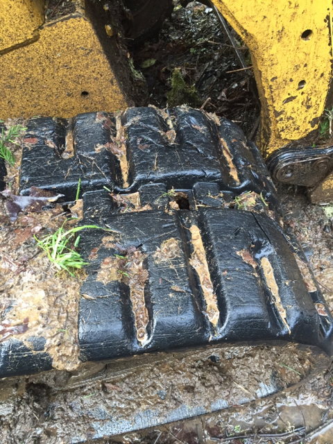

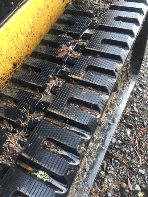

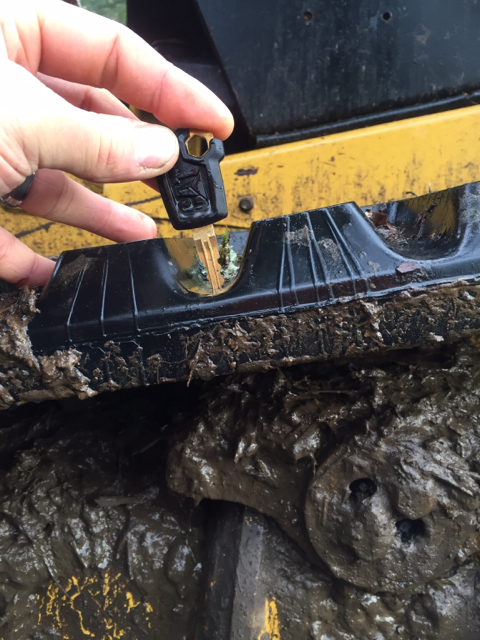

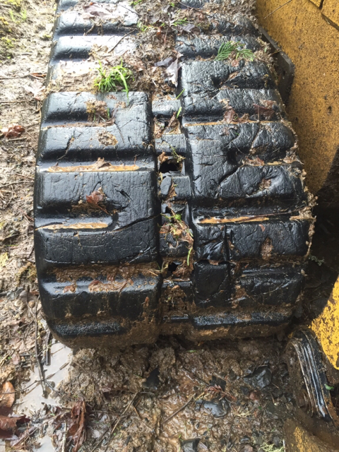

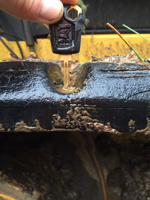

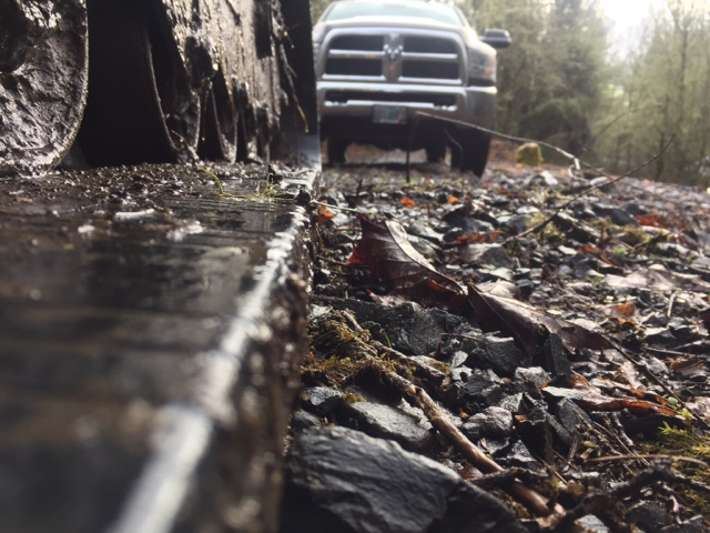

Here are some comparisons between the 1000hr track and new one. You can see it is torn up but not worn severely. Another thing i thought of was that the trelleborgs that i have 1000hrs on were mostly used by employees and they were fresh learning to handle it employees. The oems that lasted 1500hrs where entirely run by me, the owner.

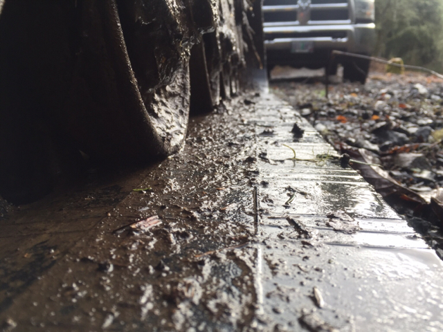

Here you can see the slope out on the inside of the track. It's not a ton but it definitely makes a difference.

Thanks for those pics, those are great. Those look better than my oem at 1000 hours. They look amazing newreal nice sharp lines. I thought they would've chipped more but yours look better at 1000 hours than other aftermarket's I've seen. Curious to see what pafarmer things. Since he goes through lots of tracks too.

My tread at 1100 hours is down to the top of the lugs for the sprocket. Yours are still above those lugs looks like a little ways, too mad about the break, looks like you could've gone a ways more.

I think it's fantastic wear for the amount of hours on them and like the looks when brand new. I plan on ordering a few sets for my 259 D machines. Both 259 D are brand new units but its a great price on a top quality track IMHO... Striking while the iron is hot on a couple of sets on these to replace my OEM set ..Can't beat the price .....
