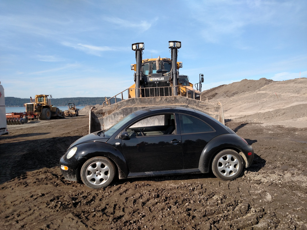

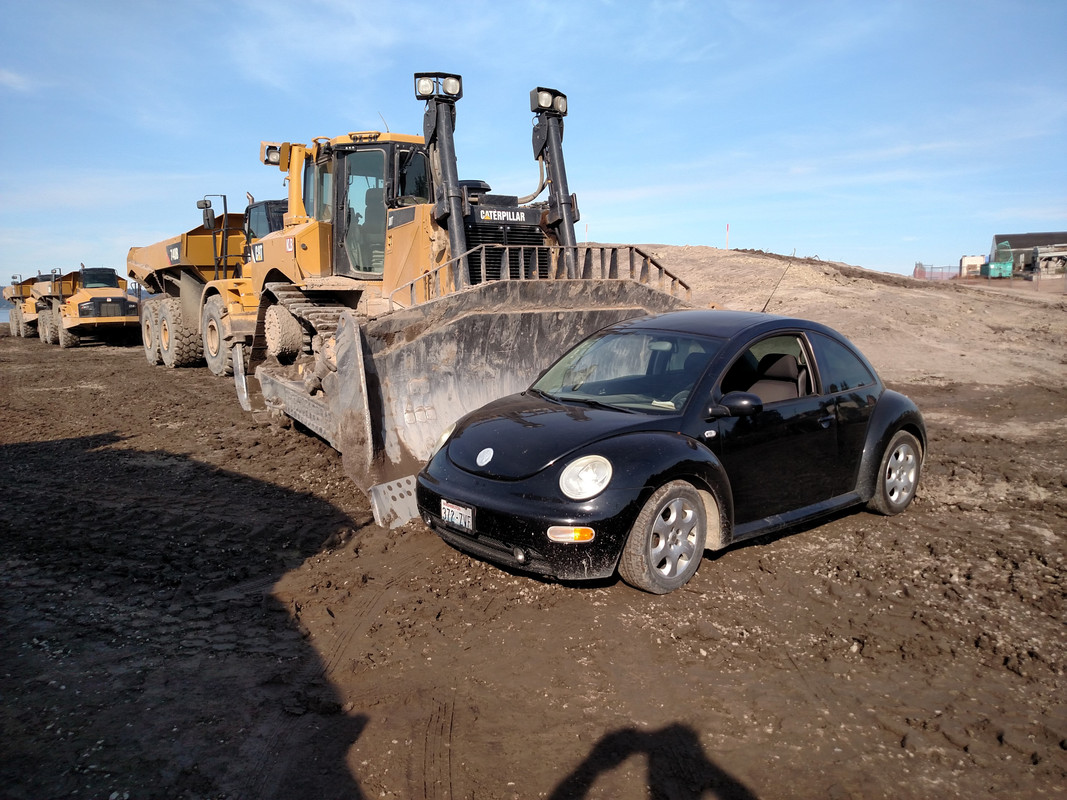

I don't have cameras on the dirt equipment. It is not a requirement nor is it something to replace looking around. On those high track dozers the front view is the worst. Cross behind me please.
i have posted this set of images for years now, and GLY safety has put it in their presentations. They don't have dozers or do dirt work but they like the graphic.
From the operator's seat, lean one way:
lean the other way:
15,946
