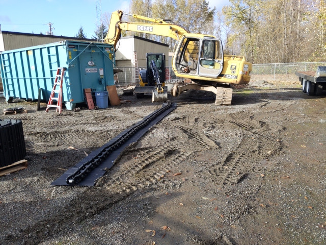

OK i got the tracks yesterday, and boy do I feel silly!!
These are not interference pins on the replacement tracks. They are slip fit with a notch and a cross pin you heat up, bend over, and torch off the remainder.
No offense at the little iron comment. I have been an operator for 30 years and have operated through 750 sized machines. :)
I do love the portability of the 120.
I managed to wrestle one on today. I found another lower roller I wanted to replace, so the second track will be waiting on parts. I have to put together a torch, so I just yarded the old track off using the mini excavator.
I unrolled and pulled the new track under, then fed it up over the sprocket. It was one of those days I could not get any help, so it was a lot of jumping between machines to get it done. I set it up to make the pin at the top of the idler.
I did not need a come-along or anything besides a hammer and a big pair of channel lock pliers.
9,581
It was!

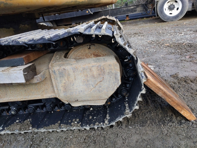

Started out like this:
Then the mini and I said " come with us you worn out slinky!
new track rolled out ready to drag through. This is where it would be easier to back onto the new track, but I was not set up right for that. Maybe on the other side Monday.
