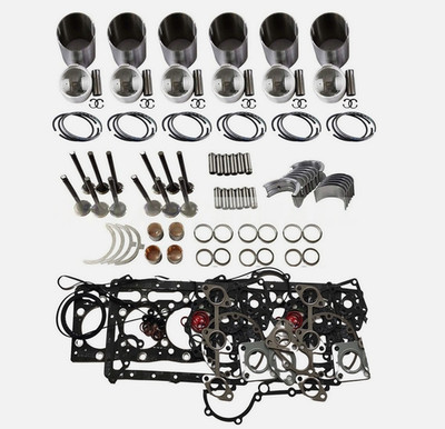

For those who are not awful fond of the S6D125 motor which is in this beast... would this not alleviate your concerns regarding parts availability for it?
I am also able to find undercarriage parts and external engine parts as well.

I have done a few completes of these engines, the aftermarket parts are terrible at best compared to original and fuel pumps and some other parts including wiring harnesses are gone. Parts suppliers can tell beautiful stories till the installing mechanic finds out the parts you just spent $2500 on do not and will not ever fit. They can not even make a gasket properly on more than one that I built. Had to die grind head bolt holes in head gaskets to fit the pattern on the block.
That was with KMP parts which are about the best for Komatsu. I could talk on the phone for 4 hours straight about the last old D155A Komatsu motor I rebuilt in 2023 and all the problems we encountered with it and the parts problems.
All the best to you. I would run and never look back. Same year for a Cat I would look at maybe.

We had to buy exhaust manifolds for the last one from China. Beautiful looking. The bolt holes were 1/2 inch out and they have been recycled in the steel bin and no they did not pay back.
We bought through a fuel injection shop Parts for a fuel pump from England for mega bucks, but they were genuine and worked 100%. They were the last ones to be found anywhere. China had all kinds but non of the shops would buy cause they were no fit junk.
