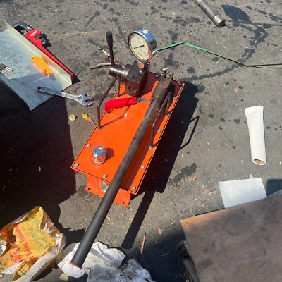

Since I am waiting for the tracks and it was a nice afternoon, I took off two shoes on one track surrounding the master pin:
Note that in this photo you can see some of the rust that makes me think this machine might have been in a coastal environment.
Removing the shoes was beyond what my 25-year old "600 ft-lb" Craftsman 1/2" air impact could do reliably. It got 3 of the eight bolts, the other five I had to use a breaker bar with a cheater.
The outside head of the master pin is keyed to prevent rotation:
I tried sticking a big crescent wrench on it but was not able to rotate it.
The inside end of the master pin had a retainer in the form of a rod with bent ends. It made me think of a thick copper ground wire -- except it was some kind of steel. The ends broke off when I tried to straighten them out. I flattened one side with the grinder and laid into it with a punch. I was able to push the end of the pin retainer in about 1/8 of an inch below the surface. However the other end did not come out at all, so I think I was just packing that pin into the hole like a rivet.
At that point I drilled the retainer out:
I probably should have used a larger drill. The exit hole shows that my drill was too small:
I guess I can go in with a bigger drill tomorrow.
I then tried driving the pin towards the outside with no luck. I also tried an air hammer with a blunt bit. Also no movement.
So I can try heating the link with the cutting torch to free the pin . . . hey, wait a minute . . . if I have the cutting torch right there anyway . . .
Is there a downside to using ye olde flameaxe on the old chain? It is just going to recycling as far as I know.
A press seems overkill for a single job:
Thoughts? Comments? Advice?
