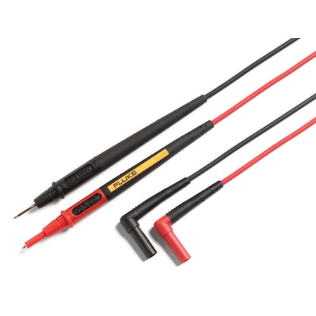

Quality test leads make a world of difference and less frustration along the way. I've ordered mine from Zoro.com. Pasternack.com has been used for many patch, and RF energy usage type cables also.
Kind of $$$, but if you make a living with test equipment.....
