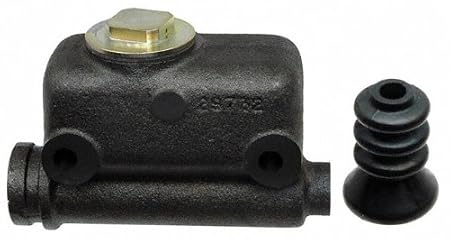

I have just bought a MF Backhoe. Registration tells me it is a 1971 (that may not be accurate) and the previous owner told me it was a MF50A. Serial is 9A110504 and the loader is model 300 serial 1196003744, fairly close to some of the other numbers previous. It has the 4spd dual pedal "instant reverse" transmission.
My problem is brakes. I have a single hydraulic pedal on the left front of the steering wheel and dual mechanical pedals to the left rear. None of the AGCO parts manuals show the single hydraulic Master cylinder. Do you know what model this would be?

Without a pic I'm guessing.
Do you mean you have a master cylinder that controls both brakes hydraulically? Nothing power or driven off the engine hydraulics, just a typical master cylinder with a slave cylinder at each brake? I believe I saw that on a 304, not a 50, maybe it was an option?
What is the problem besides no brakes? Do you actually want to get those brakes working? Do the individual mechanical pedals have any effect right now?

Yes, as well as the 2 mechanical pedals under the seat, there is a single pedal to the front that goes to a single hydraulic master cylinder (which I cannot find in any of the parts catalogs) and the axle has the internal wet disks and is built for the 1676387M92 slave cylinders. It all looks very OEM.
So far this is the only picture I have, I'll take more.

Mike, Delmer, I have photos. Here is my brake set up:
The seat is pushed back to get a good photo of the floor and pedals. The two rear pedals are independent mechanical and the front single pedal is to a single hydraulic cylinder (which I will show below). Other side of the cab (front) is the instant reverse forward/reverse pedals. Here is the single brake master cylinder that I cannot find a replacement for:
The line to the slave cylinders is off at the moment, as are the slave cylinders. one was mounted above the spring at the far right side of the photo. I have ordered new slave cylinders. These where totally seized. I was able to free up the master cylinder and filled it with mineral oil on a recommendation. I was told mineral oil (ATF or light hydraulic) fights corrosion better and the seals are made for either. Good idea?
I am told that the serial number 9A110504 is for a MF150A. I picked up an operator's manual for a MF150A and it shows TWO front hydraulic brake pedals. My local dealer's fische shows no hydraulic brakes on this model.

I have the exact same master cylinder somewhere, also rusted up and leaking.
I'm not sure on the oil vs brake fluid, I can't argue with that logic. I'd try to find seals for the master cylinder you have. Most likely it's a standard bore and won't be too hard to find seals, you just have to DIG, and be prepared to substitute.
That sure would be nice to have dual hydraulic brakes, but I suspect it would have been easier to buy a backhoe that had them to start with. Most backhoes that old are lucky to have two functional mechanical brakes...

Hey Delmer, it is and odd mounting. Most master cylinders mount from the front, not those two top bolts.
If I could find another I could twin them side by side and just run each to each slave cylinder.
Pedals would be easy to gear up using the original as a pattern.
I'd prefer to use common MF or generic Master Cylinders if I could find one.
I have motorcycles that use mineral oil for brakes and clutch and very pleased with their life and operation.
Water will collect in the low spots but they tend to repel water better to begin with, especially when submerged.
Previous owner was using brake fluid. New slaves can run either but I don't know what this master cylinder is.

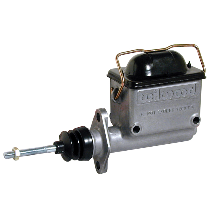

An old car enthusiast gave me some help on the brake master cylinder.
He said it was a very common design in the 1950's and 60's. Chev truck, AMC and even Jeep CJ5 up until late 60's.
All of them are 3" mounting bolt spacing, 1.25" from rod. An example is AC DELCO 18M932
Totally interchangeable and very common and cheap. Wilwood even makes a direct replacement for Hot Rods.
Problem is the bore diameter. Originals were from 5/8" to 1.25" depending on application. 1" bore was very common.
The slave cylinders are the same deal, many bore diameters. I ordered the original for the tractor but don't know the bore.
Running dual master cylinders generally requires a smaller bore than a single. These are cheap enough to experiment.
All the new replacement cylinders specify DOT3 or DOT4 fluid, no mention of mineral oil, so may need to rethink my fluid.
Just waiting for my slave cylinders to arrive...
