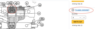

I'm looking for the caps for the injection pump that the injector lines screw into. The attached diagram from Cat lists them as "Bonnets", but the image Cat provides on their parts page looks like the other image.
7S-6683. The four on my injection pump are all chipped, probably due to over tightening....
Are there any Injection Pump gurus that have seen this before?

You do know you need a special splined tool to remove the nut holding it and you have to remove the four injection pump to to change the bonnet
So the pump needs to come off machine to change the bonnets? Any idea the part number of that splined tool?
Looks like it might be the 8T-5287. Is that correct?

not the whole pump just the 4 pumps for each cylinder. there is a clip that goes around the bonnet and pump I might have the number of tool I'll have to go root around in my tool box Are the injection lines leaking??

Thank goodness......I was starting to sweat it! I found what must be the tool. Each of my nozzles has internal splines around the threaded part, so 8T-5287 appears to be the one. I've ordered from Cat and will pickup tomorrow. Thanks for the headsup!
