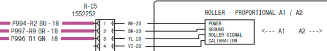

So you have the older style thumbwheel roller control with a proportional magnetic switch. With the key switch ON, backprobe the same Pin Numbers 2 & 3 (in this case green & brown wires) of the 12-pin connector without disconnecting anything. You should measure around 4.5v with the thumbwheel roller in the centre, around 2v with it rolled fully one way and around 7v with it rolled fully the other way. Again look for stability in the output voltage with the roller in a certain position.
After you do that get the floor up and take a good look at the AUX ECM for dirt contamination and/or corrosion. The ECM location on your machine is very prone to that if the area is not kept clean and dry. Water ingress to the ECM is also a possibility, that can make them do strange things. The one you should pay close attention to is the one on the RH side of the cab, but look at the one on the left while you have the floor up, some cleaning now could save problems later.

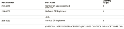

That is the top of my list. If I have to get a new one, do they have to be programmed?
Yes they do, because they are used in more than one product line. The installed software creates the "identity" for the required application.
An unprogrammed ECM is 216-0658. There is also a Reman Part Number 10R-5613.
If your current ECM has been damaged by water ingress it is highly unlikely that it will be acceptable as a Core Return for a Reman ECM.
The required software P/N for your machine ZSA03364 is 284-3058.
An 216-0658 ECM already programmed with 284-3058 software is available under Part Number 284-3059.
