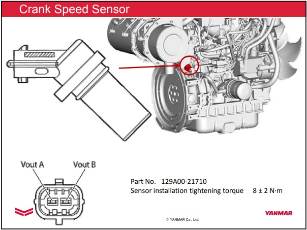

this generator has a 3 cyl yanmar diesel (3tnv88). would anyone happen to know where its engine speed sensor is? Keep getting a rpm fail code in the controller and can't seem to find where its getting its signal.

Mag pickup usually on bell housing unless they are using generator frequency and the generator is not putting out voltage. What control is being used?

AC03, I think. I'm also going to say mechanical, even though the controller does everything, from starting to shut down. That is my problem, I have three of these generators that I need to get operating and all three are doing different things.
#1; controller says its going through its prestart, cranking etc and the engine is doing nothing at all.
#2; actually runs (so far, after a lot of work) haven't checked if it is making power.
#3; Controller starts it , cranks for 5 seconds and shuts down. Has a rpmmeasfail code. So I'm guessing its getting a no rpm code and controller is shutting down like it supposedly should.

I have a pile of TNV series manuals I can email you, but without knowing the specific engine it might just add more confusion. I did look in a Yanmar T4 reference book and found where your crank sensor should be located.
If you can provide any pictures of the engines we can narrow it down by the fuel system type.
Some controllers will read engine speed off of the generators frequency/HZ at the AC output, the sets you're working on are most likely reading off of a crank sensor from what I could gather in that AC03 manual link above.

I can't find anything on bell housings. wish I could figure out how to get post pictures ( I have pix of most things on generators) .
Also, controller says generators that run are putting out 220v and 60 htz.

Marshall (got your pm, thanks); can't find anything at all on bellhousings that resembles a sensor. What is this about a frequency sensor that can sense the rpm? My son and I are working slowly almost wire by wire and we're making some progress. But thus rpmeasfail fault is driving us nuts. The other faults you can work your way through them, but since we cannot find the way these engines measure rpm its aggravating.
