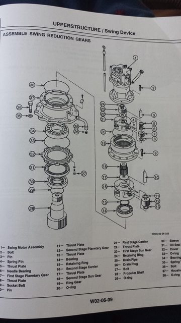

Have two issues with the swing motor reduction gear unit.
1. The unit is leaking gear oil through the slew ring & onto the belly almost as fast as it goes in, almost...
2. The reduction gear unit housing is cracked at the bolt support flange holes but has been stable for a long time and seems to work just fine besides the gear oil leak.
I don't know if the cracked support holes are related to the leaking gear oil and was hoping to receive some constructive critique of the situation and possible repair solutions. It's a personal machine used to do some work on our lot and quite frankly running low on funds to repair these large ticket items.
I've read in several posts that the leak may be a reduction gear shaft seal which some have said is a reasonably easy repair, which I'm hoping. I don't have a problem pulling the swing motor assembly to make DIY repairs.
So the questions are, based on the gear shaft seal being located in the reduction gear housing;
1. Can the flange housing be welded?
2. Is the gear shaft seal replaced from the bottom of the unit or do I need to split the swing motor section from the reduction gear housing section?
3. Would anyone happen to have pictures of the bottom of the assembly or instructions on how to do the seal change?
4. Worse come to worse, can just the lower reduction gear unit be replaced somewhat low cost?
Any help would be much appreciated?

Structural cast, broken like that is junk. You are better off finding used and making one from 2. The pinion got loose as a result the oil leaked out. Do you have locating dowels left or are they gone?
By your parts illustration, it looks like you have to press the pinion out of the bearing to access the seal and carrier.

Last time I saw one that bad the slew bearing was shot and bucking up and down. You will at the very least need a new swing gear case. I would also be concerned about the bore in the house that the case fits into. The case is usually very tight and takes some persuading either with jacking bolts or capable crane and a lot of shaking.

Came out and apart easily. Mine only required a new seal. Bearings and planeteries are all easy to inspect once apart. Mine's been holding oil since. I bought my manuals online from tradebit, they were cheap and covered the disassembly and reassembly well, as I recall. Looks like you have a manual, can't find the re&re section?
As far as the crack, looks like it ends at the hole, and is now relieved, if it hasn't cracked any further I wouldn't worry about it.
