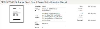

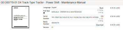

Seeing as it appears you don't know too about the operation and maintenance of this tractor my advice would be to get hold of some manuals regarding Operation & Maintenance. This requires two separate manuals, one for Operation, the other for Maintenance. Each one costs $30 to download from the Cat Pubs web site. For the Ops manual, put SEBU5270 in the box, for the Maintenance manual put GEG00779 in the box. In each case click the Search button. Once you go to the checkout the documents are available in about 5 minutes.
