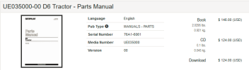

For a Parts Manual go to - https://catpublications.com/
When the popup appears click on "Continue as Guest".
Type UE035000 in the box and click the Search button. The illustration below should appear.
If you decide to purchase a download you'll have it within 5 minutes. If you buy a CD or paper manual there will be S&H charges on top of the posted price.
