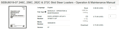

Question: Do you have an Operation & Maintenance Manual.? They are not expensive in the grand scheme of things. The Cat Publication reference is SEBU8019. Sometimes you can find used copies online but often at higher prices than a new one from the OEM.
